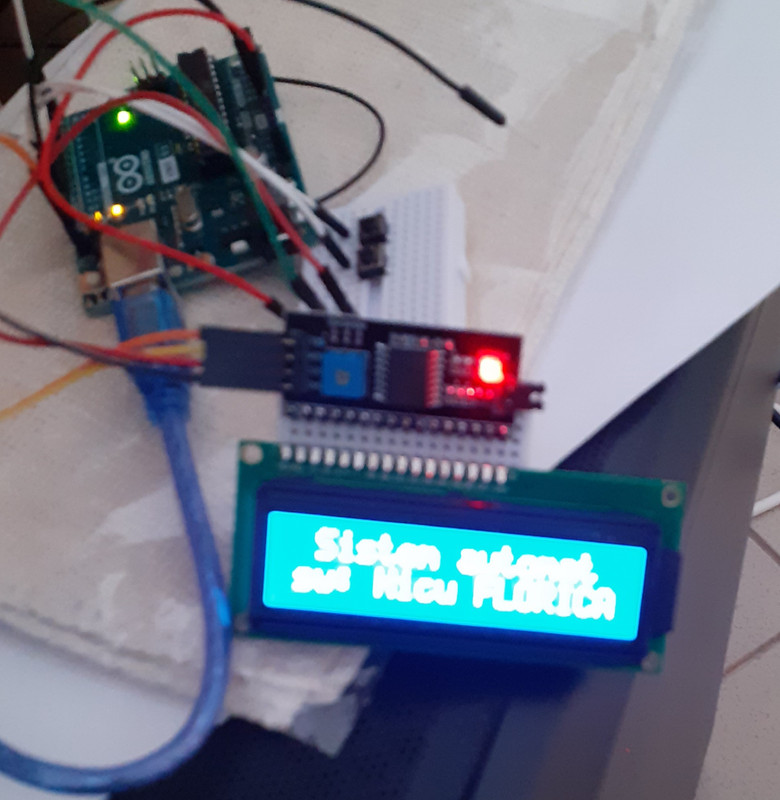

daniels Postat Octombrie 4 Partajează Postat Octombrie 4 (editat) Vreau sa fac o masina de bobinat la care sa setez un numar de spire, masina le bobineaza, iar la final se opreste Nu stiu ce biblioteca LiquidCrystal_I2C.h foloseste, dar initial nu tiparea nimic. dupa ce am schimbat linia lcd.begin(16,2); // initialize the LCD cu lcd.init(); // initialize the lcd lcd.init(); tipareste doar liniile lcd.backlight(); // Turn on the blacklight and print a message. lcd.setCursor(0,0); lcd.print(" Sistem automat "); lcd.setCursor(0,1); lcd.print("sw: Nicu FLORICA"); Varianta originala a softului /* counter with threshold original sw by Nicu FLORICA (niq_ro) */ #include <Wire.h> #include <LiquidCrystal_I2C.h> // Set the LCD address to 0x27 for a 16 chars and 2 line display LiquidCrystal_I2C lcd(0x27, 16, 2); volatile int provimp; // measures sensor pulses unsigned int totalimp = 0; // total impulses; unsigned int totalimp0 = 10; // previous impulses; int prag = 50; // default threshold #define senzor 2 // Sensor Input (D2) #define sw1 12 // pin for increase the threshold #define sw2 11 // pin for decrease the threshold #define releu 13 // pin for relay #define atras LOW #define repaos HIGH void numarare() // Interrupt function { provimp++; } byte starebuton1,starebuton2; // the current reading from the input pin byte citirestarebuton1, citirestarebuton2; // byte ultimastarebuton1 = HIGH; // the previous reading from the input pin byte ultimastarebuton2 = HIGH; unsigned long ultimtpdebounce1 = 0; // the last time the output pin was toggled unsigned long ultimtpdebounce2 = 0; unsigned long tpdebounce = 50; // the debounce time; increase if the output flickers unsigned long tpactionare = 0; // momment at activate relay unsigned long tpcomanda = 1000; // activate relay time in ms void setup() { lcd.begin(16,2); // initialize the LCD lcd.clear(); // clear the screen lcd.backlight(); // Turn on the blacklight and print a message. lcd.setCursor(0,0); lcd.print(" Sistem automat "); lcd.setCursor(0,1); lcd.print("sw: Nicu FLORICA"); pinMode(senzor, INPUT); digitalWrite(senzor, HIGH); // Optional Internal Pull-Up pinMode(sw1, INPUT); pinMode(sw2, INPUT); digitalWrite(sw1, HIGH); digitalWrite(sw2, HIGH); pinMode(releu, OUTPUT); digitalWrite(releu, repaos); delay(3000); lcd.clear(); Serial.begin(9600); Serial.println(" ");Serial.println(" ");Serial.println(" "); Serial.println("------------------------------------------"); Serial.println("counter "); attachInterrupt(0, numarare, RISING); // Setup Interrupt sei(); // Enable interrupts } void loop () { // button reading citirestarebuton1 = digitalRead(sw1); // read the state of the switch into a local variable: if (citirestarebuton1 != ultimastarebuton1) // If the switch changed, due to noise or pressing: { ultimtpdebounce1 = millis(); // reset the debouncing timer } if ((millis() - ultimtpdebounce1) > tpdebounce) { if (citirestarebuton1 != starebuton1) // if the button state has changed { starebuton1 = citirestarebuton1; if (starebuton1 == LOW) // only toggle the LED if the new button state is LOW { Serial.println("sw1"); prag = prag + 5; if (prag > 100) prag = 5; totalimp = 0; } } } citirestarebuton2 = digitalRead(sw2); // read the state of the switch into a local variable: if (citirestarebuton2 != ultimastarebuton2) // If the switch changed, due to noise or pressing: { ultimtpdebounce2 = millis(); // reset the debouncing timer } if ((millis() - ultimtpdebounce2) > tpdebounce) { if (citirestarebuton2 != starebuton2) // if the button state has changed { starebuton2 = citirestarebuton2; if (starebuton2 == LOW) // only toggle the LED if the new button state is LOW { Serial.println("sw2"); prag = prag - 5; if (prag < 5) prag = 100; totalimp = 0; } } } // count part totalimp = totalimp + provimp; // count all impulses provimp = 0; // Reset Counter if (totalimp != totalimp0) { Serial.print(totalimp, DEC); // Print litres/hour Serial.println(" pulses -> "); Serial.println("------------------------------------------"); } lcd.setCursor(0,0); //lcd.print("n: "); if (totalimp < 1000) lcd.print(" "); if (totalimp < 100) lcd.print(" "); if (totalimp < 10) lcd.print(" "); lcd.print(totalimp,DEC); // Print total pulses lcd.print(" / "); lcd.print(prag); // Print threshold lcd.print(" "); totalimp0 = totalimp; // decision part if (totalimp >= prag) { totalimp = 0; digitalWrite(releu, atras); lcd.setCursor(15,0); lcd.print("*"); tpactionare = millis(); } if (millis() - tpactionare > tpcomanda) { digitalWrite(releu, repaos); lcd.setCursor(15,0); lcd.print(" "); } ultimastarebuton1 = citirestarebuton1; ultimastarebuton2 = citirestarebuton2; } // end main loop si varianta putin modificata /* counter with threshold original sw by Nicu FLORICA (niq_ro) */ #include <Wire.h> #include <LiquidCrystal_I2C.h> // Set the LCD address to 0x27 for a 16 chars and 2 line display LiquidCrystal_I2C lcd(0x27, 16, 2); volatile int provimp; // measures sensor pulses unsigned int totalimp = 0; // total impulses; unsigned int totalimp0 = 10; // previous impulses; int prag = 50; // default threshold #define senzor 2 // Sensor Input (D2) #define sw1 12 // pin for increase the threshold #define sw2 11 // pin for decrease the threshold #define releu 13 // pin for relay #define atras LOW #define repaos HIGH void numarare() // Interrupt function { provimp++; } byte starebuton1,starebuton2; // the current reading from the input pin byte citirestarebuton1, citirestarebuton2; // byte ultimastarebuton1 = HIGH; // the previous reading from the input pin byte ultimastarebuton2 = HIGH; unsigned long ultimtpdebounce1 = 0; // the last time the output pin was toggled unsigned long ultimtpdebounce2 = 0; unsigned long tpdebounce = 50; // the debounce time; increase if the output flickers unsigned long tpactionare = 0; // momment at activate relay unsigned long tpcomanda = 1000; // activate relay time in ms void setup() { lcd.init(); // initialize the lcd lcd.init(); lcd.clear(); // clear the screen lcd.backlight(); // Turn on the blacklight and print a message. lcd.setCursor(0,0); lcd.print(" Sistem automat "); lcd.setCursor(0,1); lcd.print("sw: Nicu FLORICA"); pinMode(senzor, INPUT); digitalWrite(senzor, HIGH); // Optional Internal Pull-Up pinMode(sw1, INPUT); pinMode(sw2, INPUT); digitalWrite(sw1, HIGH); digitalWrite(sw2, HIGH); pinMode(releu, OUTPUT); digitalWrite(releu, repaos); delay(3000); lcd.clear(); Serial.begin(9600); Serial.println(" ");Serial.println(" ");Serial.println(" "); Serial.println("------------------------------------------"); Serial.println("counter "); attachInterrupt(0, numarare, RISING); // Setup Interrupt sei(); // Enable interrupts } void loop () { // button reading citirestarebuton1 = digitalRead(sw1); // read the state of the switch into a local variable: if (citirestarebuton1 != ultimastarebuton1) // If the switch changed, due to noise or pressing: { ultimtpdebounce1 = millis(); // reset the debouncing timer } if ((millis() - ultimtpdebounce1) > tpdebounce) { if (citirestarebuton1 != starebuton1) // if the button state has changed { starebuton1 = citirestarebuton1; if (starebuton1 == LOW) // only toggle the LED if the new button state is LOW { Serial.println("sw1"); prag = prag + 5; if (prag > 100) prag = 5; totalimp = 0; } } } citirestarebuton2 = digitalRead(sw2); // read the state of the switch into a local variable: if (citirestarebuton2 != ultimastarebuton2) // If the switch changed, due to noise or pressing: { ultimtpdebounce2 = millis(); // reset the debouncing timer } if ((millis() - ultimtpdebounce2) > tpdebounce) { if (citirestarebuton2 != starebuton2) // if the button state has changed { starebuton2 = citirestarebuton2; if (starebuton2 == LOW) // only toggle the LED if the new button state is LOW { Serial.println("sw2"); prag = prag - 5; if (prag < 5) prag = 100; totalimp = 0; } } } // count part totalimp = totalimp + provimp; // count all impulses provimp = 0; // Reset Counter if (totalimp != totalimp0) { Serial.print(totalimp, DEC); // Print litres/hour Serial.println(" pulses -> "); Serial.println("------------------------------------------"); } lcd.setCursor(0,0); //lcd.print("n: "); if (totalimp < 1000) lcd.print(" "); if (totalimp < 100) lcd.print(" "); if (totalimp < 10) lcd.print(" "); lcd.print(totalimp,DEC); // Print total pulses lcd.print(" / "); lcd.print(prag); // Print threshold lcd.print(" "); totalimp0 = totalimp; // decision part if (totalimp >= prag) { totalimp = 0; digitalWrite(releu, atras); lcd.setCursor(15,0); lcd.print("*"); tpactionare = millis(); } if (millis() - tpactionare > tpcomanda) { digitalWrite(releu, repaos); lcd.setCursor(15,0); lcd.print(" "); } ultimastarebuton1 = citirestarebuton1; ultimastarebuton2 = citirestarebuton2; } // end main loop Editat Octombrie 4 de daniels Link spre comentariu

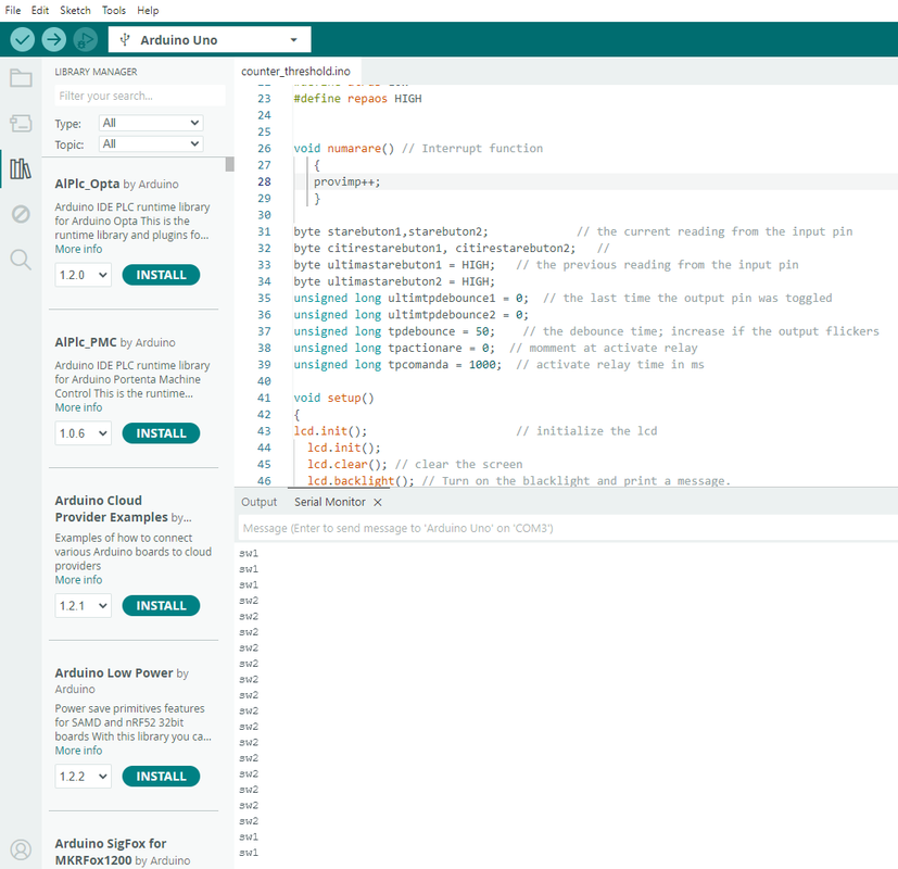

mihaiaurul Postat Octombrie 4 Partajează Postat Octombrie 4 In consola serială ce mesaje se afisează ? Link spre comentariu
daniels Postat Octombrie 4 Autor Partajează Postat Octombrie 4 (editat) Initial arata 1. Senzorul este hall si daca dau cu degetul pe sub placuta incepe sa numere. Butoanele nu functioneaza. Editat Octombrie 4 de daniels Link spre comentariu

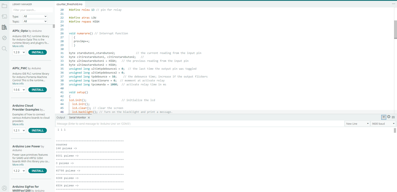

mihaiaurul Postat Octombrie 4 Partajează Postat Octombrie 4 44 minutes ago, daniels said: Senzorul este hall si daca dau cu degetul pe sub placuta incepe sa numere. La ce interval vin mesajele in consolă ? Poti afișa si timestamp. Iconiță in dreapta la fereastra consolă. Link spre comentariu
daniels Postat Octombrie 4 Autor Partajează Postat Octombrie 4 Fiecare rand cu pulses-> este o atngere de deget pe sub CI. Numara foarte repede. Link spre comentariu

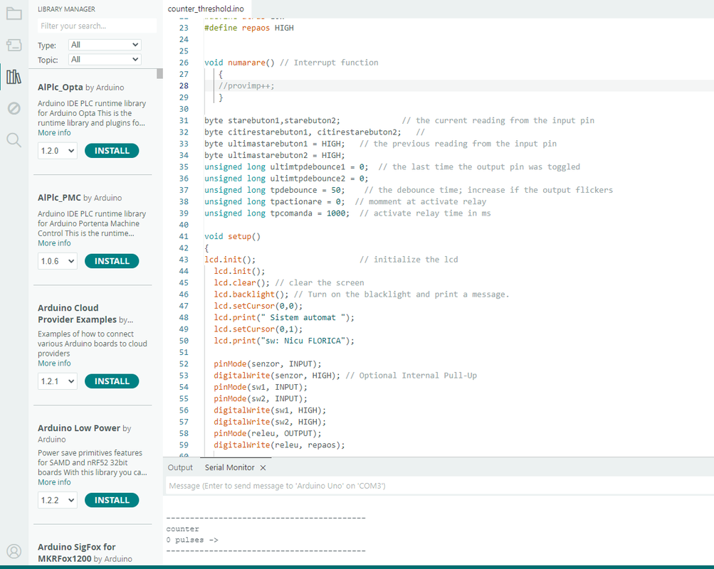

mihaiaurul Postat Octombrie 4 Partajează Postat Octombrie 4 (editat) 2 hours ago, daniels said: provimp++; Comentează linia asta din void numarare() si vezi daca merg butoanele. Adică ce se afisează in consolă. Se pare că programul tău intră foarte des în intrerupere din cauza senzorului. Eventual dezactivează intreruperea HAL, sau deconectează senzorul și apasă pe butoane. Ce se afisează in consolă ? Editat Octombrie 4 de mihaiaurul Link spre comentariu
daniels Postat Octombrie 4 Autor Partajează Postat Octombrie 4 daca comentez proimp++ nu mai nunara impulsuri. Daca scot senzorul incep sa functioneze butoanele. Link spre comentariu
mihaiaurul Postat Octombrie 4 Partajează Postat Octombrie 4 (editat) 20 minutes ago, daniels said: Daca scot senzorul incep sa functioneze butoanele. Este clar atunci. Programul tău stă mai mult în intrerupere decăt să ruleze. De ce asta ? Habar nu am. Poate nu corespunde senzorul, poate nu este bine filtrată tensiunea de alimentare ... Pentru teste, pune un C de 1-10nF pe pinul de intrerupere și GND. Un osciloscop te-ar fi scos din impas. Editat Octombrie 4 de mihaiaurul Link spre comentariu

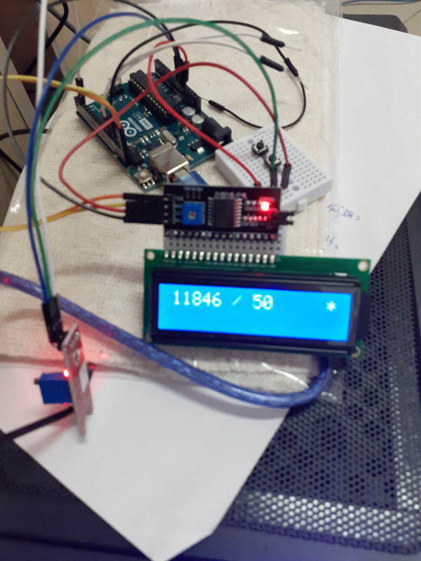

niq_ro Postat Octombrie 4 Partajează Postat Octombrie 4 (editat) din pozele postate butanele au conectate doar catre Arduino nu sunt conectate si la masa... https://nicuflorica.blogspot.com/2021/03/numarator-impulsuri-cu-prag-reglabil.html PS: pare ca si senzorul magnetic nu e conectat la GND... fa te rog o poza din care sa reiasa ca respecti schema Editat Octombrie 4 de niq_ro Link spre comentariu
daniels Postat Octombrie 4 Autor Partajează Postat Octombrie 4 (editat) Erau conectate corect, dar pt ca am ajuns sa suspectez intrerupatoarele, am scos un fir negru la masa cu care atingem direct firele din arduino. In ultima captura erau montate corect si se vede ca functionau bine. Editat Octombrie 4 de daniels Link spre comentariu

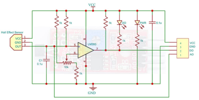

niq_ro Postat Octombrie 4 Partajează Postat Octombrie 4 (editat) senzorul e conectat la Arduino cu aimentare si pe iesirea digitala la D2 al lui Arduino? senzor.... Arduino =============== A0 ........... liber G ........... GND + ............. 5V D0 ............ D2 Editat Octombrie 4 de niq_ro Link spre comentariu
