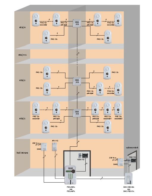

iod2 Posted November 14, 2012 Share Posted November 14, 2012 sar gasii o schema la el?problema nu se aude in centrala si nici in post. releul lucreaza si cam atat. Quote Link to comment Share on other sites More sharing options...
leoncris Posted November 14, 2012 Share Posted November 14, 2012 Intercom intrerupt la unul din utilizatori.(Este inseriat cu toti utilizatorii) Quote Link to comment Share on other sites More sharing options...
iod2 Posted November 14, 2012 Author Share Posted November 14, 2012 in centrala e problema. ea nu lucreaza nici singura. se aude releul cum cupleaza (semiduplex) dar nu se aude nimic.diful e bun. Quote Link to comment Share on other sites More sharing options...
leoncris Posted November 14, 2012 Share Posted November 14, 2012 Sursa scoate corect cele 2 tensiuni?Iala (electromagnetul) lucreaza ? Quote Link to comment Share on other sites More sharing options...
iod2 Posted November 14, 2012 Author Share Posted November 14, 2012 face tot, mai putin ce am zis mai sus.vroiam o schema pentru am niste piese notate cu T care cred ca sunt tranzistoare....dar la aparat nu prea zice nimic. testerul nici nu le recuneaoste. pe ele scrie W18. Quote Link to comment Share on other sites More sharing options...
leoncris Posted November 14, 2012 Share Posted November 14, 2012 http://www.datasheetcatalog.org/datashe ... /85012.pdf Quote Link to comment Share on other sites More sharing options...
iod2 Posted November 14, 2012 Author Share Posted November 14, 2012 ale mele au numai 3 picioare. Quote Link to comment Share on other sites More sharing options...
iod2 Posted November 15, 2012 Author Share Posted November 15, 2012 nimeni nici o idee? Quote Link to comment Share on other sites More sharing options...
leoncris Posted November 15, 2012 Share Posted November 15, 2012 Lasa mail in PM si'ti trimit ... manualul. Quote Link to comment Share on other sites More sharing options...
MIKI33 Posted April 23, 2021 Share Posted April 23, 2021 Salut grup.Noi avem o prpblema la interfonul Electra model vechi si posturi interioare 10 pe scara ca poti intra cu cartela dar daca faci apel la orice apartamen audio merge dar nu deschide Yala din butonul postului.Care ar fi cauza?Posturile sunt model IA02.Multumesc anticipat.Mar interesa daca posturile sunt legate in serie sau paralel in distribuitor? Quote Link to comment Share on other sites More sharing options...
