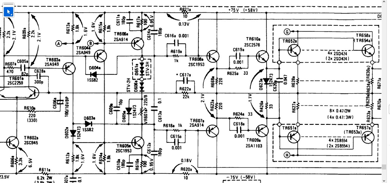

Guest Posted January 5, 2024 Share Posted January 5, 2024 https://www.worthpoint.com/worthopedia/bell-audio-5005-power-amplifier-power-312720956 Asta e un amplif profesional care bate la fund cam toate hi-fi-urile care le-am ascultat...cu exceptia Kortingului. Cred ca au fost cateva sute. Link to comment
ex.escu Posted January 5, 2024 Share Posted January 5, 2024 Au fost facute de fostex pentru bell , vezi fostex 300/600. Link to comment
dumitrumy Posted January 5, 2024 Share Posted January 5, 2024 (edited) ************************************************************************* Edited January 5, 2024 by dumitrumy Link to comment
Guest Posted January 5, 2024 Share Posted January 5, 2024 O schema foarte simpla, multumiri, nu o aveam. Link to comment
