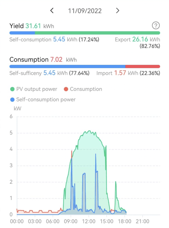

merck Posted September 11, 2022 Share Posted September 11, 2022 Astazi in Iasi la un amic, panouri cu orientare spre Sud (vreo 15 grade diferenta), 6kW instalati: Link to comment
Guest Posted September 11, 2022 Share Posted September 11, 2022 (edited) Acum 14 minute, merck a spus: 6kW instalati: Ai idee cam cat l-a costat o astfel de instalatie (plus instalare) ? Edited September 11, 2022 by Guest Link to comment
