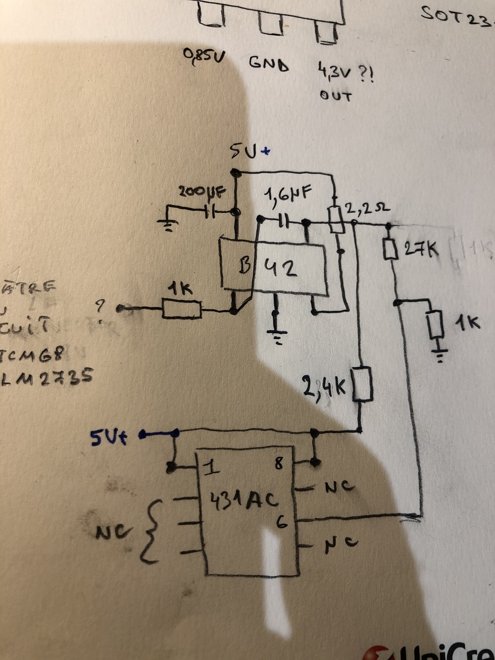

BRANCA Posted January 24, 2021 Share Posted January 24, 2021 (edited) Nu prea bate cu schema pusă prima dată.Anodul se leagă totdeauna la masă direct,nu prin rezistenţă.Mă refer la pinul 6,care e anod. Edited January 24, 2021 by BRANCA Link to comment

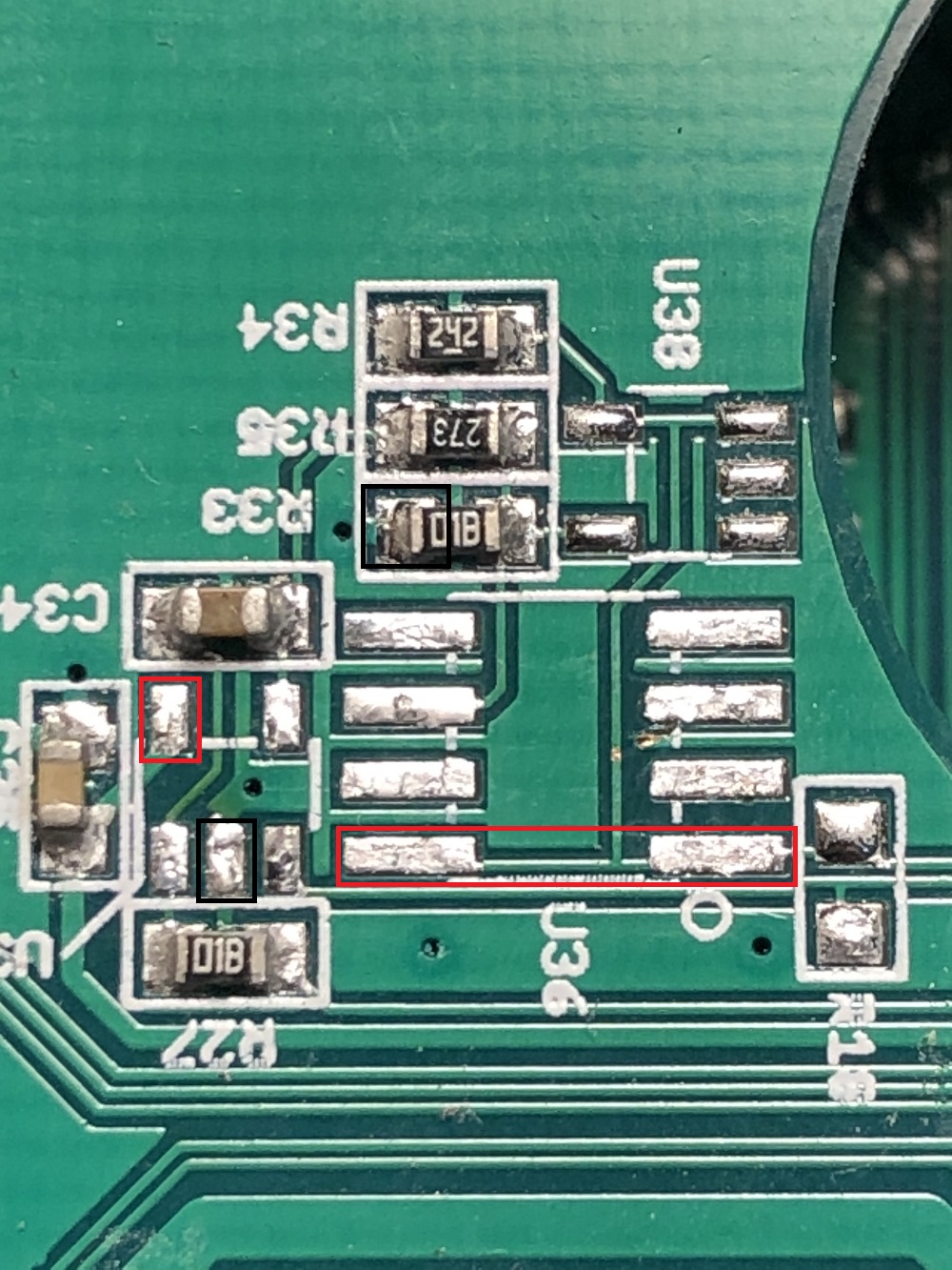

danipasc Posted January 24, 2021 Author Share Posted January 24, 2021 (edited) Asa e legat, prin acea rezistenta de 1k la masa si prin cea de 27k la integratu cu pricina. Pinul 1 si 8 sunt legate direct la 5V+. Updatez schema si o poza mai de aproape cu integratele luate jos. Am marcat pe circuit cu rosu partea de 5V+ si cu negru Gnd. U38 lipseste (optional) Edited January 24, 2021 by danipasc Link to comment
danipasc Posted January 28, 2021 Author Share Posted January 28, 2021 Da, se pare ca e un opamp. Am pus in loc un MCP6001 si merge perfect. Va multumesc pt ajutor ! Link to comment

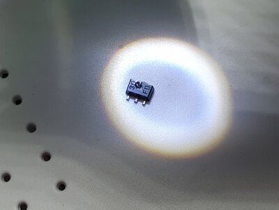

dem3ntor Posted April 4, 2021 Share Posted April 4, 2021 Sot 23 pe ea scrie 3D FD Multumesc Link to comment
UDAR Posted April 4, 2021 Share Posted April 4, 2021 Doar că în imagine nu e o capsulă SOT23 . O poză perpendiculară, de sus, și eventual o dimensiune ar ajuta. Link to comment
Dxxx Posted April 4, 2021 Share Posted April 4, 2021 Pare a fi capsula SOT89... asta pana primim detaliile cerute mai sus... Link to comment
dem3ntor Posted April 4, 2021 Share Posted April 4, 2021 Da. Sot89 este. Scuze pentru greseala Link to comment
UDAR Posted April 4, 2021 Share Posted April 4, 2021 Posibil RH5RL43AA - stabilizator 4.3V . Ar trebui să poți să-ți dai seama de pe placă dacă e sau nu . Link to comment
